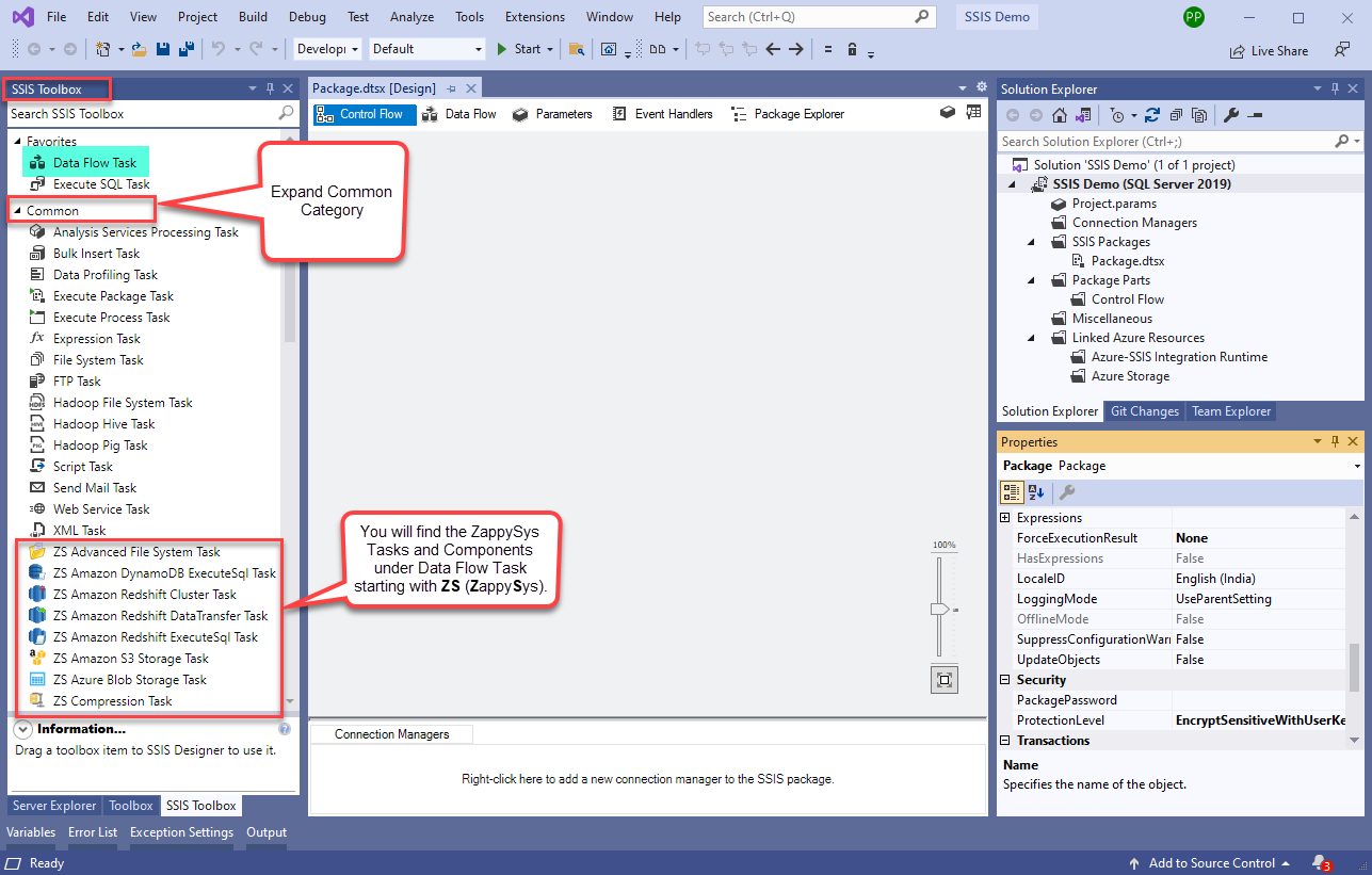

  3. In the new SSIS project screen you will find the following:
    • SSIS ToolBox on the left sidebar
    • Solution Explorer and Property Window on the right bar
    • Control flow, data flow, event Handlers, Package Explorer in tab windows
    • Connection Manager Window at the bottom
    zappysys ssis project with toolbox
    NOTE: If you don’t see ZappySys SSIS PowerPack Task or Components in the SSIS Toolbox, please refer to this help link.
