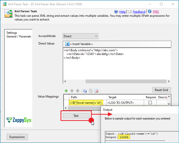

Let’s use the XML Parser Task to test XPath.
Expression 1 – Get value by direct attribute name
Write the following expression as below and click Test
1 |
//@*[local-name()='id'] |

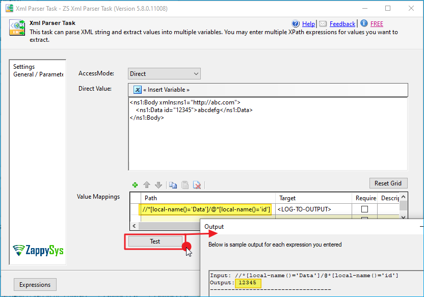

Expression 2 – Get specific element attribute value
If you want to be specific and read the value of the id attribute from a particular data element, you can use an expression like this:
1 |
//*[local-name()='Data']/@*[local-name()='id'] |

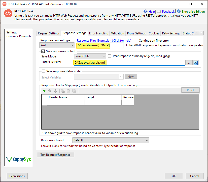

Configure the SSIS Rest API Task to filter XML Response using XPath
The screenshot below shows how to filter XML data using an XPath expression. You can save extracted data to an SSIS Variable or save it to a file.
