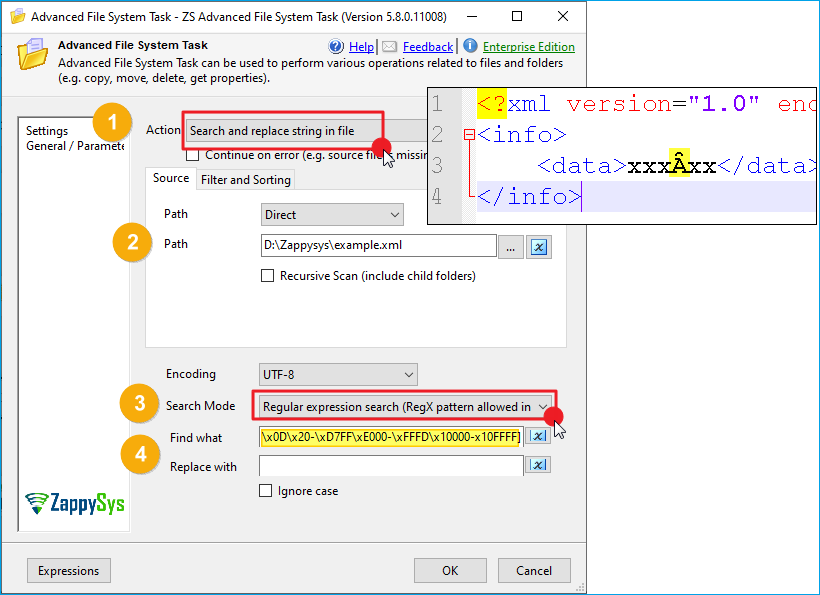

- Drag the ZS Advanced File System Task from the SSIS Toolbox to the control flow designer.
- Double-click the task to edit its properties, as shown below. Enter the following expression for a Regular Expression.
1[^\x09\x0A\x0D\x20-\xD7FF\xE000-\xFFFD\x10000-x10FFFF] - Save the package and execute. After you run the task, it will remove (replace with blank) any invalid character in your XML file.
Here is the screenshot of the Task configuration.
SSIS Advanced File System Task – Search and Replace Option -Remove invalid XML characters using Regex (Regular Expression)
