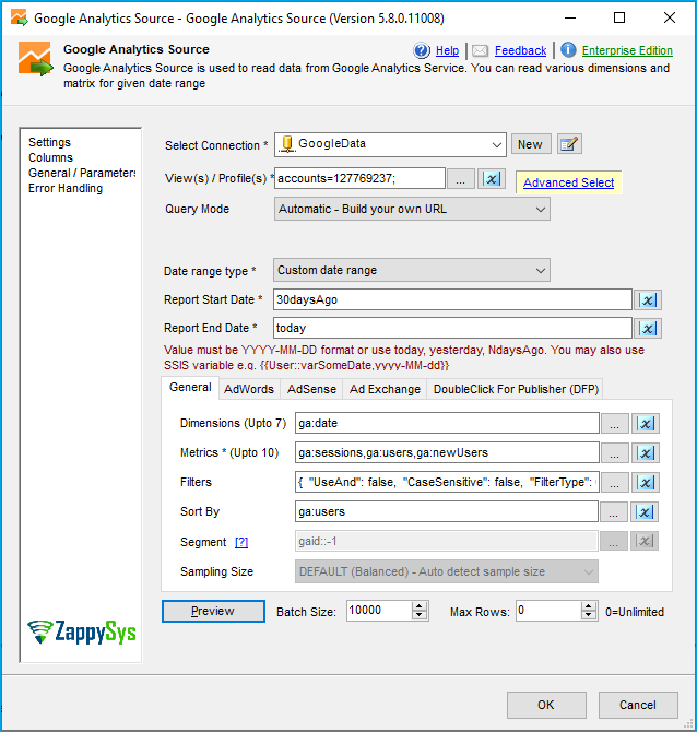

The most common solution is that if you set the Sampling option to HIGHER_PRECISION, then Google may honor your request up to a certain threshold, but as the dataset grows (e.g., if you select a larger date range), Google may sample your data even though you set HIGHER_PRECISION.
Extract data from Google Analytics in SSIS: Use the Sample Size option to get Unsampled data.
