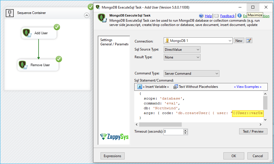

  1. Download and install SSIS PowerPack from here
  2. From the toolbox of the SSIS designer, drag  ZS MongoDB ExecuteSQL Task
  3. Click on New Connection (Next to the connection dropdown)
  4. Configure the MongoDB connection and click Test. Close UI by clicking OK
  5. Now, on the Task UI, configure it as below. Notice the “Examples” dropdown. That’s the best way to learn various commands.
  6. You can also use the “Insert Variables” option to make your command dynamic (Read value from SSIS variable)
    How to add/remove a MongoDB User in SSIS
Add MongoDB User
To add a MongoDB user using the MongoDB ExecuteSQL Task, use the following Script
Remove MongoDB User
To remove the MongoDB user using the MongoDB ExecuteSQL Task, use the following Script
