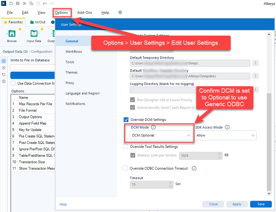

  1. Open Alteryx Designer.
  2. First, verify your DCM Settings to ensure you can access ODBC drivers. Go to Options > User Settings > Edit User Settings.
    If DCM Mode is set to DCM Only, change it to DCM Optional if you would like to access the legacy Generic ODBC Connection.
    Alteryx DCM User Settings for ODBC access
    After changing this setting, you may need to click Save and restart the connection window for the "Generic ODBC" icon to appear.

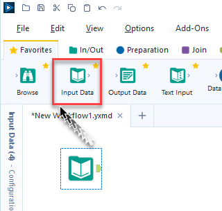

  3. Drag an Input Data tool onto your Alteryx canvas.
    Drag Input Data tool onto Alteryx canvas

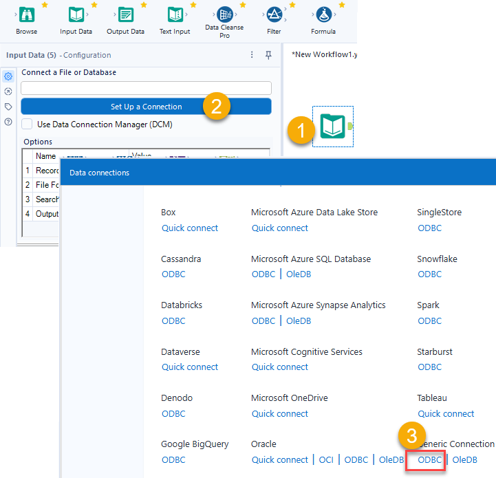

  4. In the Configuration pane, click Set Up a Connection.
    Set Up a Connection in Alteryx Input Data configuration
  5. Note for DCM Users: If your environment has DCM (Data Connection Manager) enabled, the classic "Generic ODBC" icon may be hidden. To find it, select Data sources on the left and type "ODBC" in the search bar.

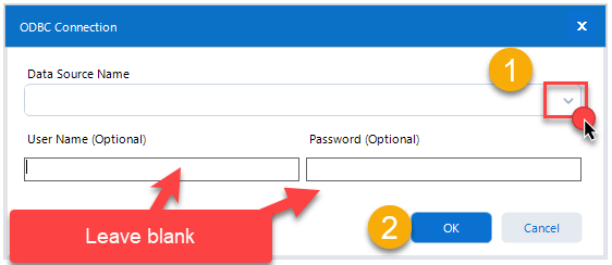

  6. Once the ODBC window opens, click Connect Asset and select your ZendeskDSN DSN from the list.
    Connect Asset and select ODBC DSN in Alteryx
    Ensure you have configured a 64-bit System DSN in the Windows ODBC Data Source Administrator before this step.

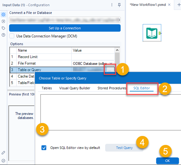

  7. After selecting your DSN, configure your SQL Query in the Input Data tool configuration:
    Configure SQL Query in Alteryx Input Data tool

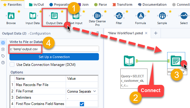

  8. To save your data, drag an Output Data tool and connect it to the Input Data tool.
  9. Configure the Output Data tool to write to a CSV file:
    Configure Output Data to CSV in Alteryx

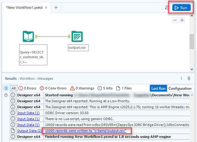

  10. Press Run (Ctrl+R) to execute the workflow. Verify the results in the Results Window at the bottom.
