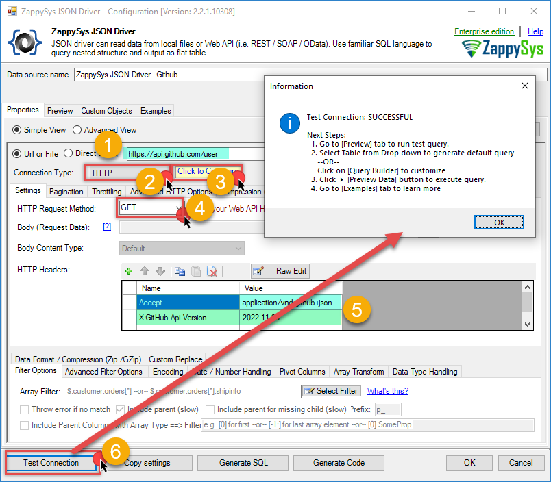

Create a new ODBC DSN using ZappySys JSON Driver
- Search for ODBC in the Windows Start menu and open ODBC Data Source Administrator.
- In the User DSN or System DSN tab, click Add.
- Select ZappySys JSON Driver and click Continue.
- Enter the base URL:
https://api.github.com/user - In Connection Type, select HTTP and click Configure.

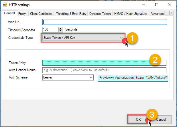

- Select Static Token/API Key as the Credential type.
- Paste your GitHub token in the authentication field.
- Click OK to save the configuration.
- Set HTTP Request Method to GET.
- Set the following values in the HTTP headers:
- Accept: application/vnd.github+json
- X-GitHub-Api-Version: 2022-11-28
- Set JSON Path Filter to extract the object array.
- Click Test Connection to verify connectivity, then click OK to save the DSN.

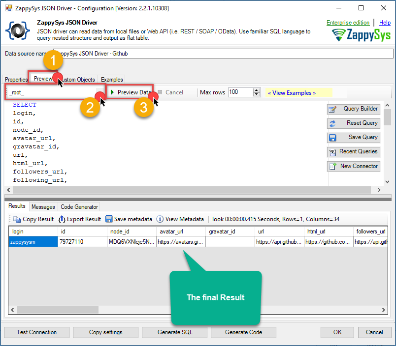

Preview GitHub data in ODBC Driver
- Go to the Preview tab.
- Generate a query, then click Preview Data to confirm that rows are returned.
- If no data is returned, verify your organisation name, token scope, and JSON Path Filter.

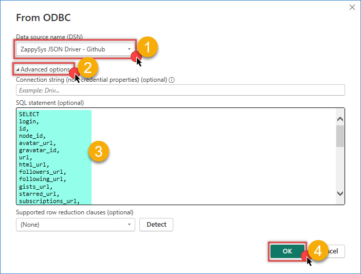

- Open Power BI Desktop.
- Click Get Data from the Home ribbon.
- Click More…, search for ODBC, and click Connect.
- Select your GitHub ODBC DSN from the dropdown list.
- Optionally, enter a custom SQL query in Advanced options.

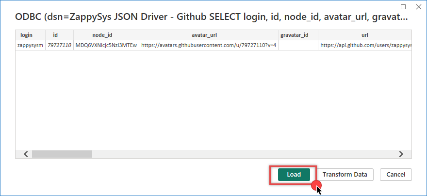

- Click OK, then click Load to import data.
- Verify the result and click Load.
- In the Navigator window, select the columns you want to load.

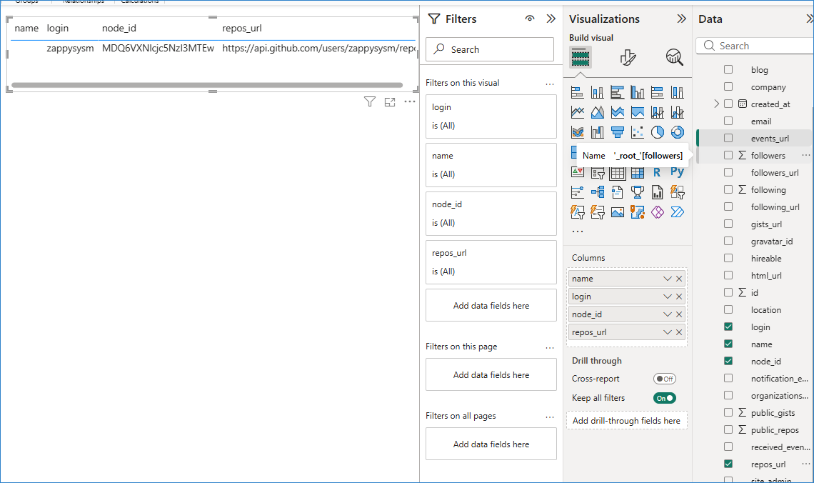

Create Useful Power BI Measures
Use DAX measures after loading the GitHub dataset:
Total Repositories
1 |
TotalRepos = COUNTROWS('nodes') |
Total Stars
1 |
TotalStars = SUM('nodes'[stargazerCount]) |
Average Forks per Repository
1 |
AvgForks = AVERAGE('nodes'[forkCount]) |
Private Repository %
1 2 3 4 5 |
PrivateRepoPct = DIVIDE( CALCULATE(COUNTROWS('nodes'), 'nodes'[isPrivate] = TRUE()), COUNTROWS('nodes') ) |
