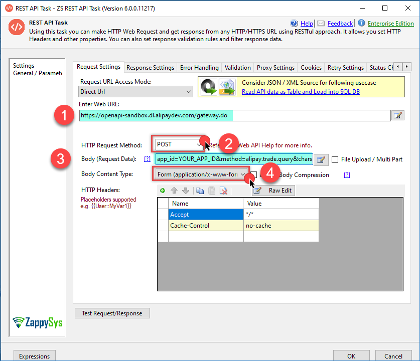

Configure the ZappySys REST API Task (Control Flow)
Use this when operating (e.g., creating a payment, refunding, or querying).
- Drag ZappySys REST API Web Service Task into Control Flow.
- Set the task:
- Method: POST (commonly used with AliPay gateway)
- URL:
1https://openapi-sandbox.dl.alipaydev.com/gateway.do - Headers: use
1Content-Type: application/x-www-form-urlencoded - Body: form-encoded parameters; use this format: key1=value1&key2=value2…
1app_id=YOUR_APP_ID&method=alipay.trade.query&charset=utf-8&sign_type=RSA2×tamp=2026-02-20 10:00:00&version=1.0&biz_content={"out_trade_no":"202602200001"}&sign=GENERATED_SIGNATURE
- Click Test Request/Response to confirm you get a valid JSON response.
