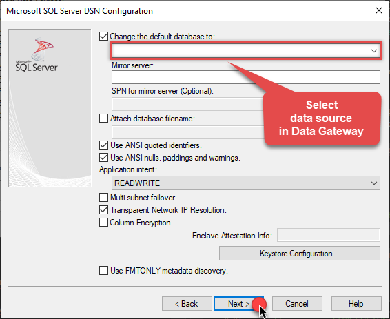

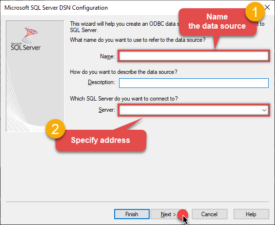

To achieve this, you must first create a data source in the Data Gateway (server-side) and then create an ODBC data source in C# (client-side) to connect to it.
Let's not wait and get going!
Create SharePoint Online data source in the gateway
In this section we will create a data source for SharePoint Online in the Data Gateway. Let's follow these steps to accomplish that:
    SharepointOnlineDSN
    ZappySys API Driver
  4. When the ZappySys API Driver configuration window opens, go back to ODBC Data Source Administrator where you already have the SharePoint Online ODBC data source created and configured, and follow these steps on how to Import data source configuration into the Gateway:

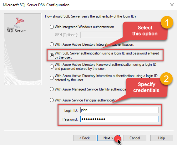

In this part we will create an ODBC data source to connect to the ZappySys Data Gateway from C#. To achieve that, let's perform these steps:
    ODBC Driver 17 for SQL Server
    ZappySysGatewayDSN
    localhost,5000

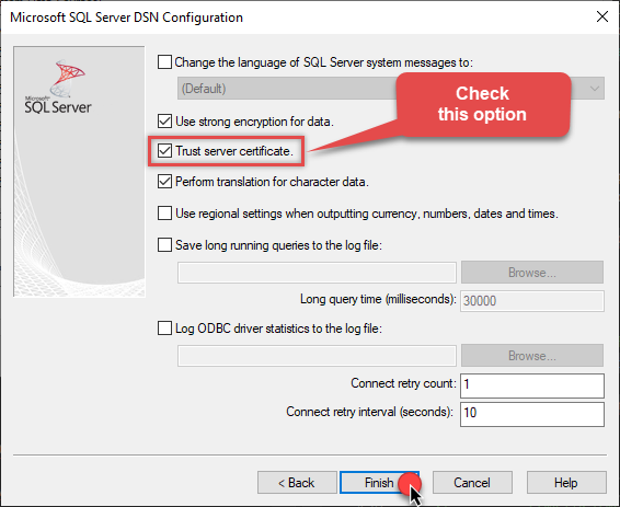

  5. Then set the default database property to SharepointOnlineDSN (the one we used in the Data Gateway):
    SharepointOnlineDSN
    SharepointOnlineDSN

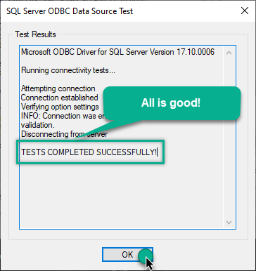

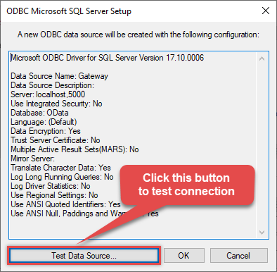

  9. Done!
