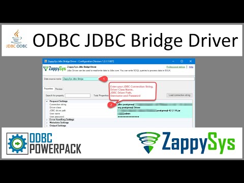

Create data source using Infor Data Lake ODBC Driver
Video instructions
Watch this quick walkthrough to see how to configure your Infor Data Lake ODBC data source, or scroll down for the step-by-step written guide.
While this video demonstrates how to connect to Postgres, the core concepts and setup process are exactly the same for Infor Data Lake.
