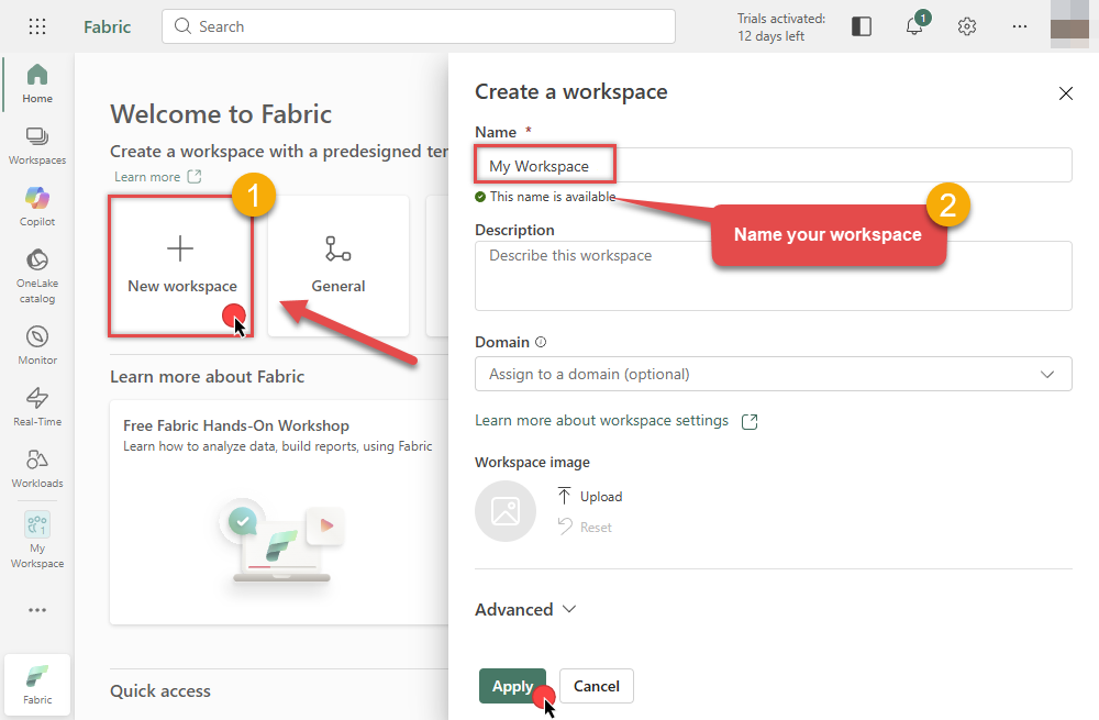

  2. Select an existing Workspace or create a new one by clicking New workspace (ensure you are in the Home section):
    Create a new workspace in Microsoft Fabric for a Copy job

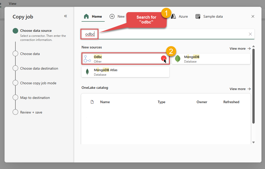

  5. In the Choose data source screen, search for odbc and select the Odbc source:
    Choose ODBC as the data source in Microsoft Fabric Copy job

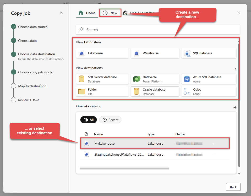

  8. Choose your Data Destination. You can create a New Fabric item (like a Lakehouse or Warehouse) or select an existing one:
    Choose data destination in Microsoft Fabric Copy job
    In this example, we will use a Lakehouse as the destination.

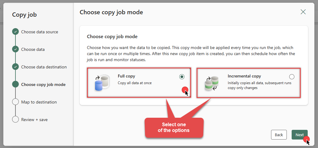

  9. Choose Full copy to load all data, or Incremental copy to load only changed data in subsequent runs:
    Select copy mode in Microsoft Fabric Copy job (Full vs Incremental)

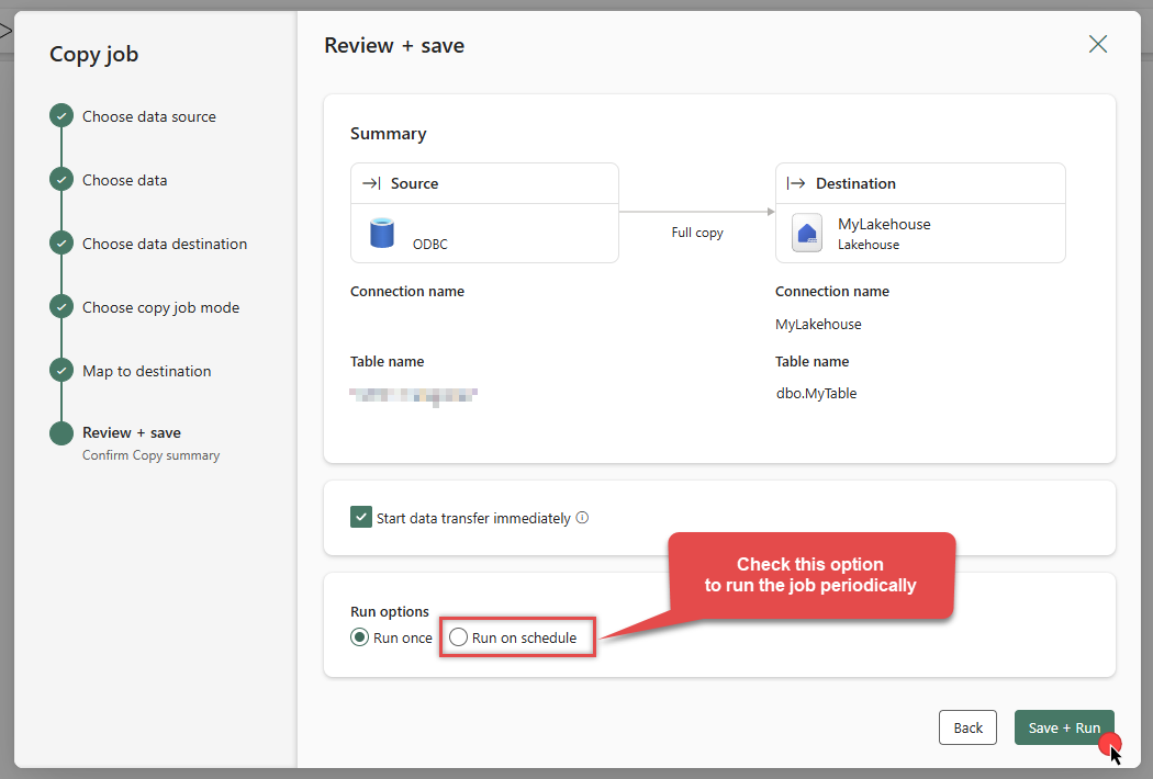

  11. On the summary screen, review your settings. You can optionally enable Run on schedule. Click Save + Run to execute the job:
    DSN=CustomApiDSN
    DSN=CustomApiDSN
    Save and run the Copy job in Microsoft Fabric

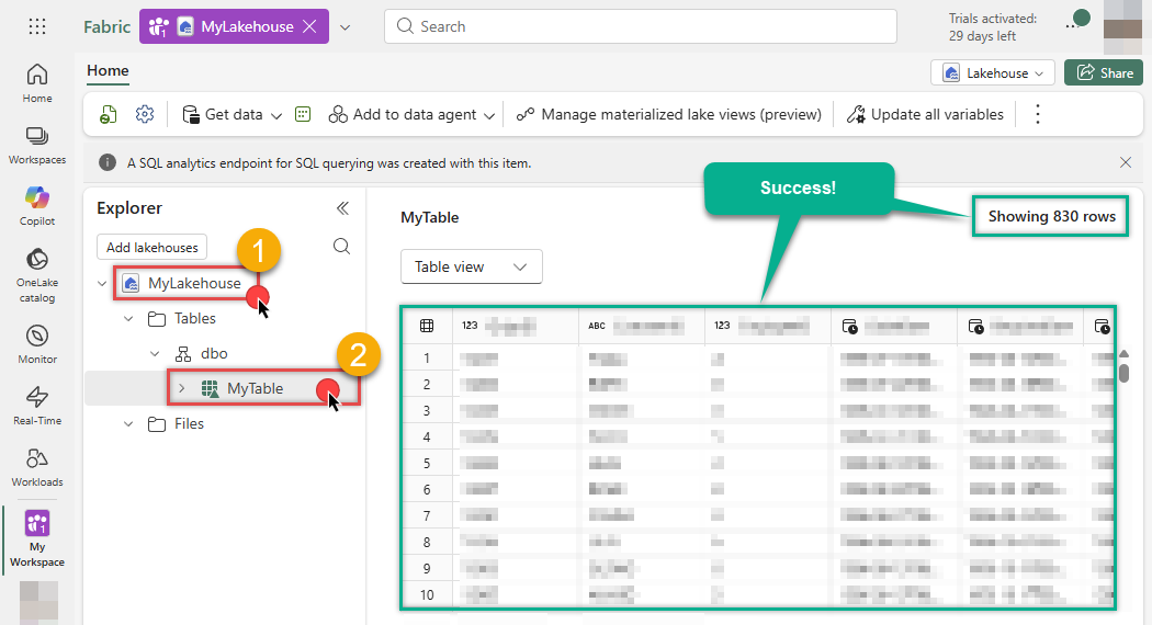

  14. Let's go to our Lakehouse (MyLakehouse) and verify the data:
    View loaded data in Microsoft Fabric Lakehouse
  15. Success! The data has been loaded.

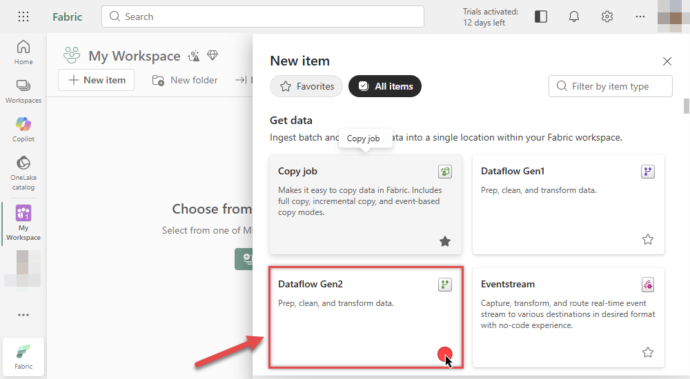

Use Dataflow for advanced transformation
Another way to load data is by creating a Dataflow Gen2. This approach allows you to perform complex data transformations (ETL) before loading the data into its destination.
Configure Dataflow activity
  1. Go to the Microsoft Fabric Portal.
  2. Inside your workspace, click New item and select Dataflow Gen2:
    Create Dataflow Gen2 in Microsoft Fabric

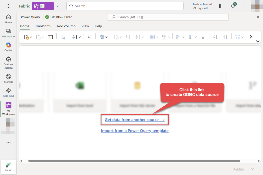

  3. In the Power Query editor, click Get data from another source:
    Get data from ODBC source in Dataflow

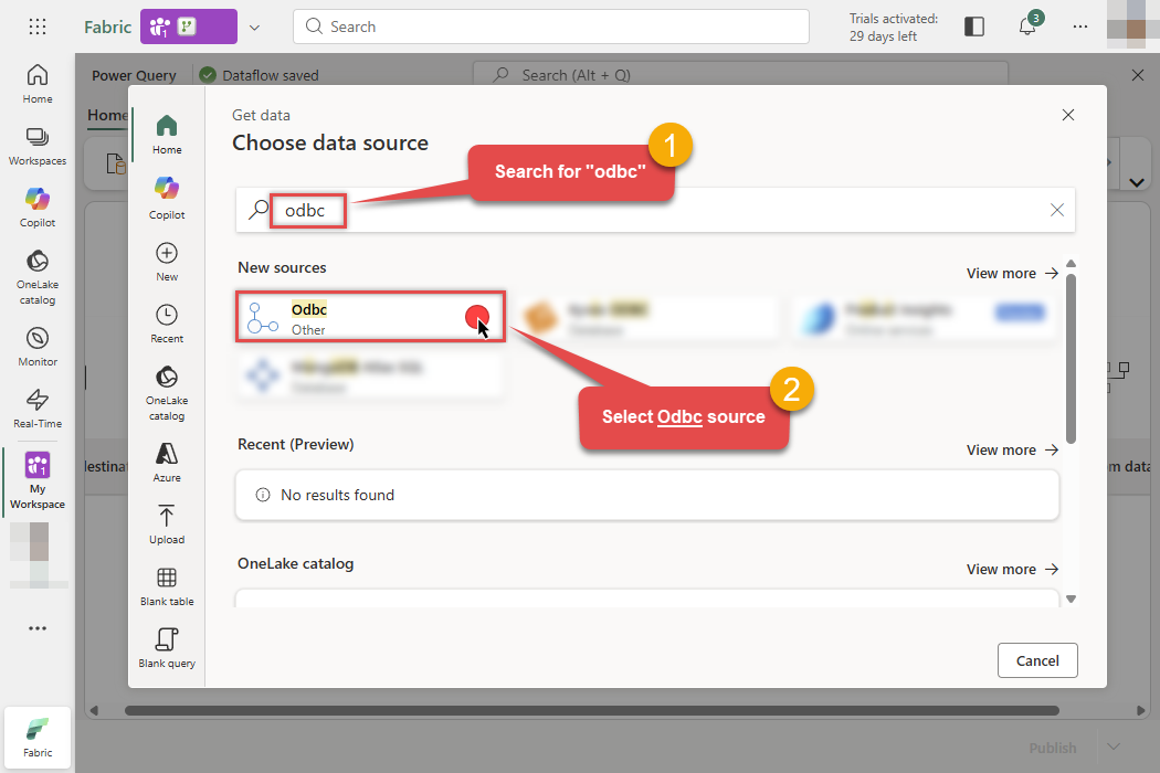

  4. Search for ODBC in the search bar and select the ODBC connector:
    Choose ODBC data source in Dataflow

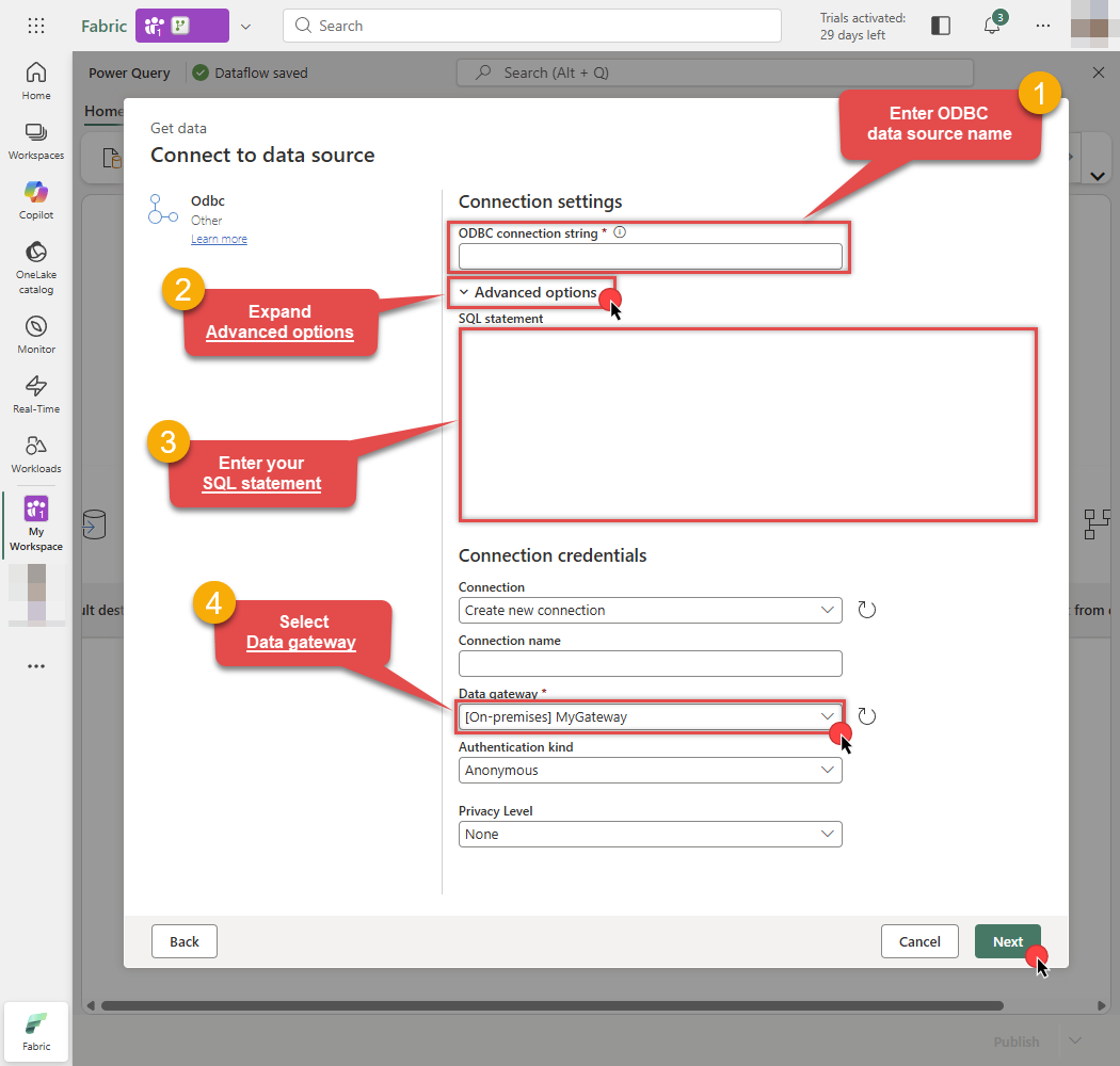

  5. Then in the next step follow these instructions:
    • Enter your ODBC connection string (e.g., DSN=CustomApiDSN)
    • Expand Advanced options
    • Enter your SQL statement
    • Select your On-premises data gateway
    • Finally, click Next:
    DSN=CustomApiDSN
    DSN=CustomApiDSN
    SELECT * FROM Orders
    Configure ODBC data source in Dataflow

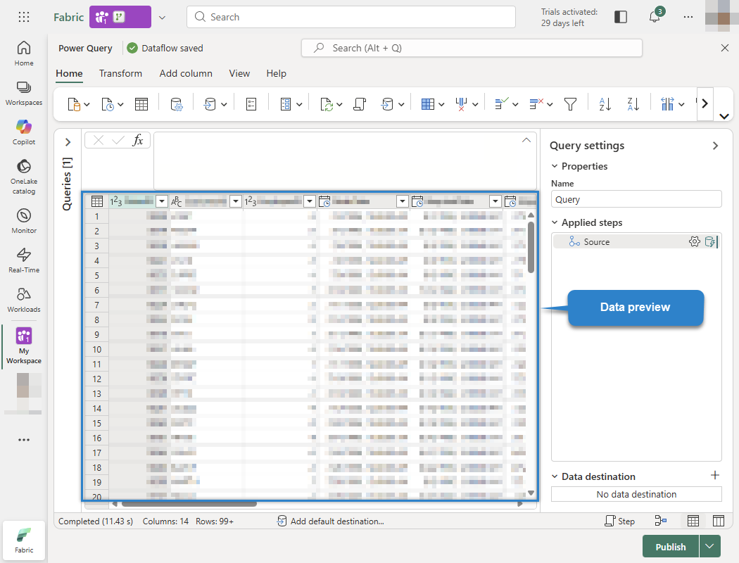

  6. You will see a preview of your Custom API data. You can now transform the data if needed (filter rows, rename columns, change types, etc.):
    Odbc.Query("DSN=CustomApiDSN", "SELECT * FROM Orders")
    Source data preview in Dataflow

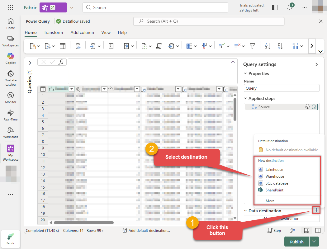

  7. Now, let's send this data to the Lakehouse. Click the + button (Add data destination) at the bottom right and select Lakehouse:
    Add destination in Dataflow

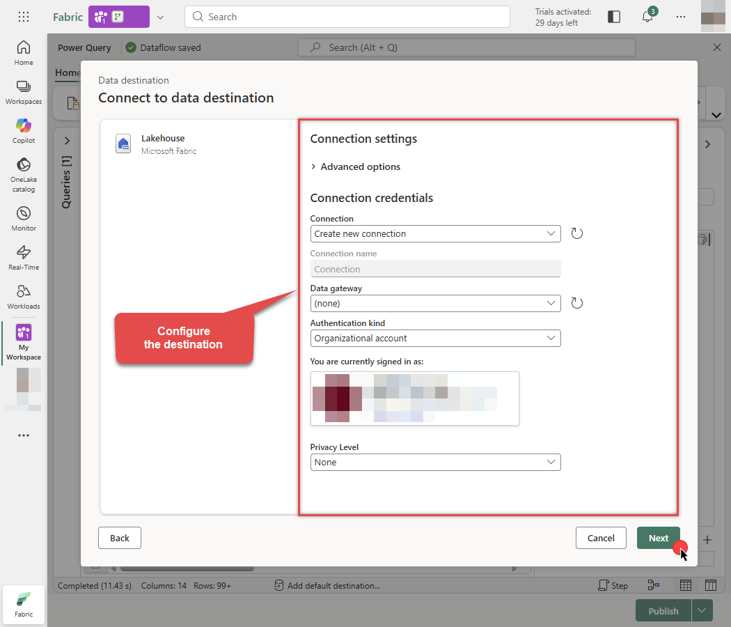

  8. Configure the destination connection settings and click Next:
    Configure destination in Dataflow

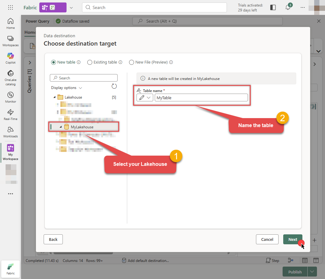

  9. Select your specific Lakehouse, enter the Table name you want to create, and click Next:
    Configure destination target in Dataflow

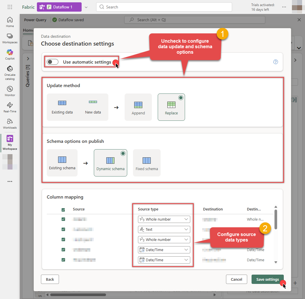

  10. Uncheck Use automatic settings to set data update or schema options manually. Map the columns with proper data types and click Save settings when done:
    Set column mappings in destination in Dataflow

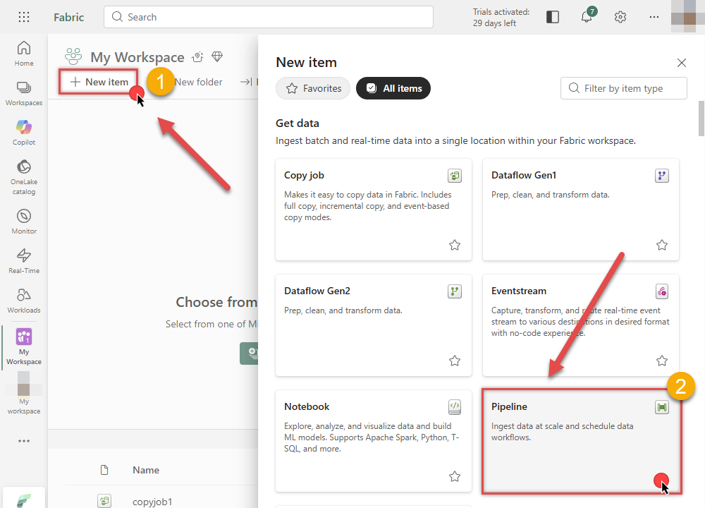

  2. Inside your workspace, click New item and select Data Pipeline to create a new pipeline.
    Create Pipeline in Microsoft Fabric

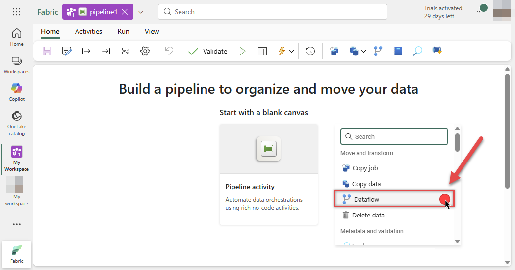

  3. In the pipeline editor, select the Dataflow activity from the toolbar to add it to your canvas:
    Add Dataflow activity to pipeline

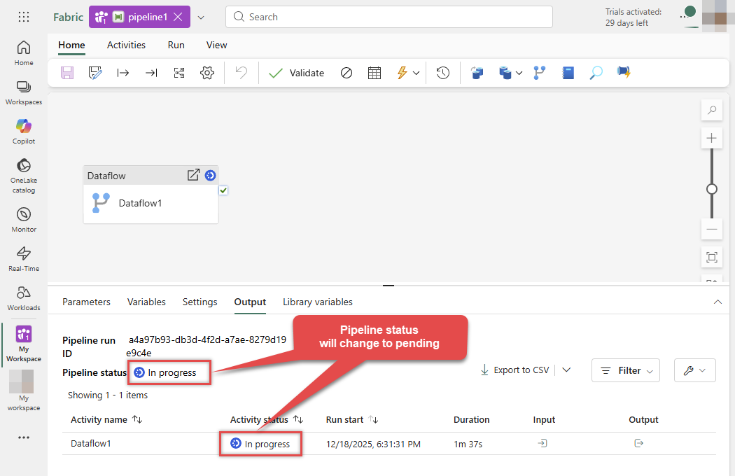

  7. Monitor the Output tab below. The Pipeline status will initially show as In progress:
    Pipeline run in progress status

  1. Go back to Microsoft Fabric.
  2. Then, go to your Copy job or Dataflow and start configuring your ODBC data source (like you did in the previous step).
  3. In the ODBC configuration window, configure these fields:
    • Enter your ODBC connection string (DSN format), for example: DSN=ZappySysGatewayDSN
    • Expand Advanced options and set the SQL statement
    • Select MyGateway from the Data gateway dropdown that you configured in the previous step
    • Select Basic from the Authentication kind dropdown
    • Enter the Username (e.g., john) and Password that you configured in ZappySys Data Gateway
