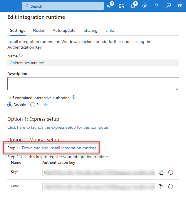

  8. Download and install Microsoft Integration Runtime.
