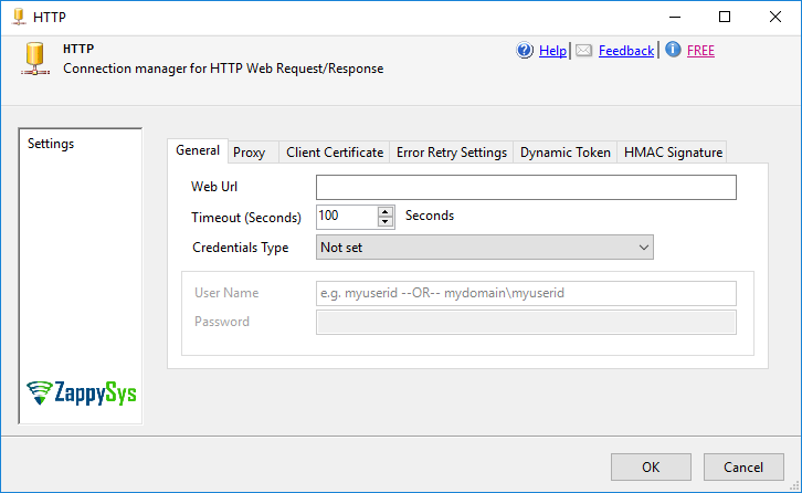

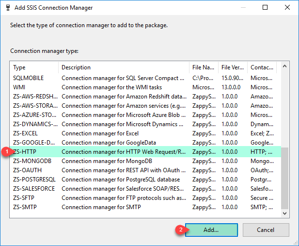

  4. Select ZS-HTTP from the Connection Managers list and Click on Add Button.
    HTTP Connection - Add

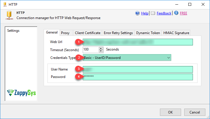

  5. In the connection manager UI, enter Web Url, set Credentials Type to Basic - UserId/Password and enter it. You can use following details for practice it.
    http://httpbin.org/basic-auth/user1/p@ss123
    User Name : user1
    Password : p@ss123
    HTTP Connection - Configure

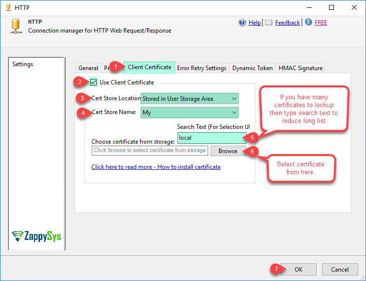

  6. In the Client certificates tab, you can do following settings.
    HTTP Connection - Client Certificates
  7. Click on OK to save HTTP Connection configure setting UI.

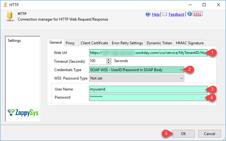

  4. Enter API URL for Workday (Make sure you don’t enter WSDL URL found here ). Your API URL will be something like below. Select credential type as SOAP WSS (This setting is only found in v2.6.4 or Higher), Enter your workday userid and password, For WSS password type setting you leave it default (Not set) or change to PasswordHash for more secure communication.
    HTTP Connection - SOAP WSS Configure
  5. Click on OK to save HTTP Connection configure setting UI.

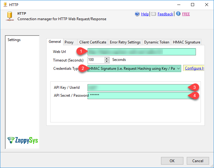

  3. Once HTTP Connection UI is visible select HMAC Authentication option, enter User ID and Password or API Key as below. If CosmosDB API example ignore Username and enter master API key. You can enter any valid URL (We will override this in next step anyways). Click on Configure HMAC Signature link.

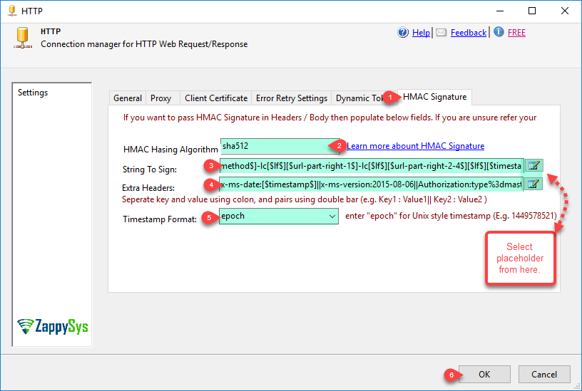

  4. Enter following 4 pieces to create correct HMAC Signature.

[$url-query-canonical] - URL parameters in Canonical Format (key and value pairs are sorted by key. Key is returned as lowercase and both key+value URL encoded) (e.g. for http://a.com/api/v1/customers?Zebra=Good&Apple Cake=Yummy ...it will return apple%20cake=Yummy&zebra=Good)
[$timestamp$]    - Indicates Current Timestamp in UTC (Use TimestampFormat property to change default Date Format which is ISO. To use Unix based time enter epoch, for custom format use something like yyyy-MM-ddTHH:mm:ss.fffZ for ISO. For Date specifier visit https://docs.microsoft.com/en-us/dotnet/standard/base-types/custom-date-and-time-format-strings)
[$nounce$]       - A unique random string (e.g. nonce). This is sometimes asked by provider to put in signature to avoid replay attack.
[$body$]         - Body text for the request.
[$body-hash-ALGORITHM[-hex][-ke]$] - (example: [$body-hash-sha256-hex$] or [$body-hash-sha256$]) This placeholder is for HASH of supplied body for current request. Replace ALGORITHM with valid name (e.g. md5, sha1, sha256, sha512). Also to Output Hash as lowercase Alphanumeric Hex suffix by -hex (e.g. [$body-hash-sha256-hex$] ). By default this placeholder is not included for GET / HEAD requests (We remove HASH and trailing \n for GET / HEAD requests). To include Body HASH regardless request Method you need to add -ke (Keep Empty) suffix. e.g. [$body-hash-sha256-ke$]
[$content-type[-ke]$] - (example: [$content-type$] or [$content-type-ke$]) This placeholder is to indicate request COntent-Type (e.g. application/json). By default this placeholder is not included for GET / HEAD requests (We remove content-type from String Format along with trailing \n for GET / HEAD requests). To include Body content-type regardless request method you need to add -ke (Keep Empty) suffix. e.g. [$content-type-ke$]
[$signature$] - Signature in base64 format. This is calculated based on HashSignatureFormat string.
[$signature-hex$] - Signature in lowercase Hex format. This is calculated based on HashSignatureFormat string.
[$token$] - If you using DynamicToken method to login first and then extract token to call next API then you can use this placeholder for Headers.
ExtraHeadersForLogin For DynamicToken mode when you enable Signature Hash, you can supply different set of Extra Headers just for login API call to include along with each requests (Key value pairs separated by double bar. Example... X-MyHeader:some-value||X-TimeStamp:[$timestamp$]||X-Signature:[$signature$] ). Your API may need to include additional headers such as Timestamp, Signature, Hash for Body. In such case you can specify header(s) in this property. You can use following Placeholders anywhere in your Header list. To supply Extra Headers for non-login calls you can set ExtraHeaders. If this property is NULL or blank then value from ExtraHeaders is used for both Login and Data calls.
NOTE:   Adding -lc after [$sometag$] will give you lowercase value (e.g. [$host$]-lc will give lowercase HOST)
 Adding -enc after [$sometag$] will give you URL encoded value (e.g. [$host$]-enc will give URL encoded value)
[$cr$]           - Indicates Carriage Return Character (same as \r)
[$lf$]           - Indicates Line Feed Character (same as \n)
[$tab$]           - Indicates Tab Character (same as \t)
[$userid$]  - Your userid or account id entered in UserName property
[$http-method$]  - Indicates HTTP Verb for current request (e.g GET, POST, PUT, HEAD, DELETE)
[$host$]         - Host name part from URL (e.g. returns www.zappysys.com for https://www.zappysys.com/someapi)
[$host-noport$]         - Host name without port number (e.g. returns myserver for https://myserver:8888 )
[$port$]         - Port number from host name (e.g. returns 8888 for https://myserver:8888 )
[$url-relative$] - Indicates URL path of current request. This part is after host name and before ? if parameters used (e.g /api/v1/customers  for http://a.com/api/v1/customers?id=123)
[$url-query$]           - URL parameters (key and value pairs) (e.g. for http://a.com/api/v1/customers?z=123&a=true it will return z=123&a=true)
[$url-path-query$] - Indicates URL path and query portion of current request. (e.g returns /api/v1/customers?id=123  for http://a.com/api/v1/customers?id=123)
[$url-part-[left|right]-N1-[N2]$] - URL part from left or right.  Where N1 is start position, N2 is end position.
  When calling part-right function N1 starts from right (1=first) and N2 starts from left (1=first).
  When calling part-left function N1 starts from left (1=first) and N2 starts from right (0=first).
  Notice that [N2] is zero based index when using part-left else start at 1.
  ***** See below examples **** for URL http://abc.com/api/v1/customers?z=123&a=true
  [$url-part-right-1$] returns..... customers
  [$url-part-right-2$] returns..... v1
  [$url-part-right-1-1$] returns... http://abc.com/api/v1/customers
  [$url-part-right-1-2$] returns... http://abc.com/api/v1
  [$url-part-right-1-4$] returns... api/v1/customers (all parts except domain and query)
  [$url-part-left-1$] returns...... http:
  [$url-part-left-3$] returns...... abc.com
  [$url-part-left-3-1$] returns.... abc.com/api/v1/customers (3rd from left till last part)
  [$url-part-left-1-0$] returns.... http://abc.com/api/v1/customers (all parts except query)
  [$url-part-left-1-1$] returns.... http://abc.com/api/v1
  [$url-part-left-1-2$] returns.... http://abc.com/api
  [$url-part-left-4-0$] returns.... api/v1/customers (all parts except first 3 parts from left)
  [$url-part-left-4-1$] returns.... api/v1
  [$url-part-left-4-2$] returns.... api
EnableRequestHashing Enable this option to add hashed signature part of request header. For now this option is only valid when you choose DynamicToken method. If you Choose HashSignature then this option is ignored.
HashTimestampFormat Timestamp format for Signature calculation. Default format for timestamp is ISO (e.g. yyyy-MM-ddTHH:mm:ss.fffZ) If you want to use Unix based format then enter word [epoch] without bracket. You can use any of these custom date format specifiers https://docs.microsoft.com/en-us/dotnet/standard/base-types/custom-date-and-time-format-strings
HashTreatSecretAsNonBase64 Treat HMAC secret / signing key as non-base64 string. By default secret is treated as base64 encoded string (see also HashSignWithApiKey). You can also suffix your key or secret with --non-base64 word and its same effect as using this option.
