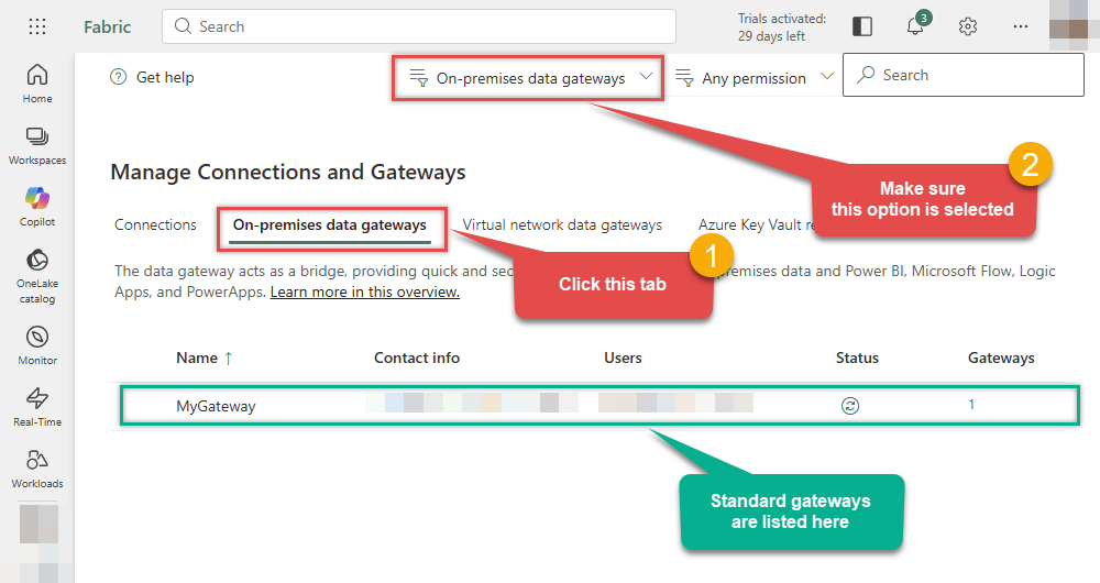

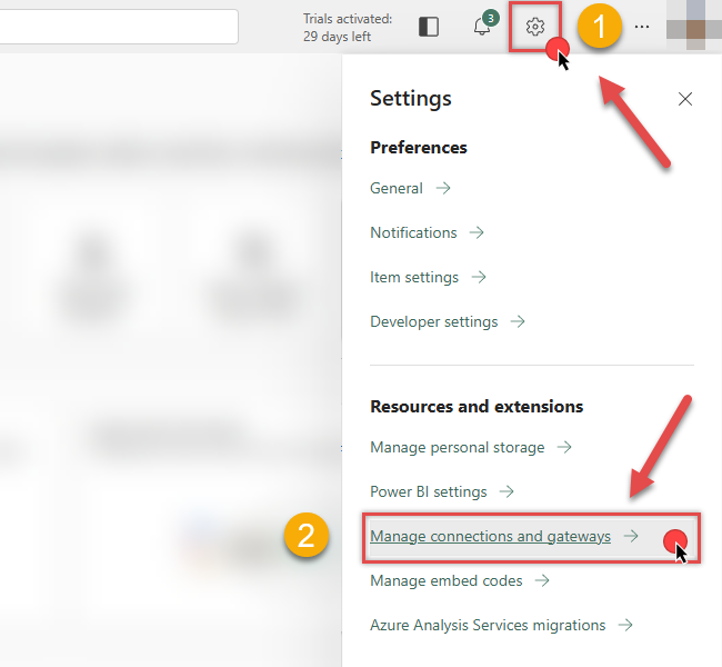

  7. Once Microsoft gateway is installed, check if it registered correctly:
    • Go back to Power BI portal
    • Click Gear icon on top-right
    • And then hit Manage connections and gateways menu item
    Manage On-premise data gateways in Microsoft Fabric or Power BI
  8. Continue by clicking the On-premises data gateway tab and selecting Standard mode gateways from the dropdown menu:
    Access On-premises data gateway list (Standard mode) in Power BI
    If your gateway is not listed, the registration may have failed. To resolve this:
    • Wait a couple of minutes and refresh Power BI portal page
    • Restart the machine where On-premises data gateway is installed
    • Check firewall settings
  9. Success! The gateway is now Online and ready to handle requests.

    Refreshing Power BI semantic model using On-premises Data Gateway
