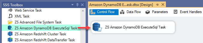

  3. Once you have Access Key and Secret Key, you may proceed to create new SSIS package. In BIDS/SSDT create new SSIS package Project
  4. In Visual Studio, from SSIS Toolbox drag and drop the ZS Amazon DynamoDB ExecuteSql Task in the design pane and double click on the task to configure it:
    Drag Amazon DynamoDB ExecuteSQL Task

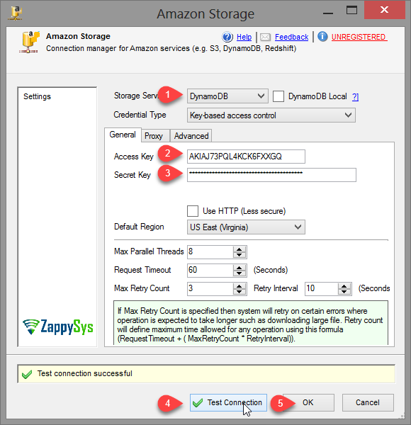

How to Create AWS-Storage Connection.
  1. Right click on Connection Managers Panel to Create New ZS-AWS-Storage, and Context Menu will appear, Select New Connection from the Context Menu.
    SSIS Amazon DynamoDB ExecuteSQL - Connection
  2. Select ZS-AWS-Storage Connection Manager from the Connection Managers list and Click on Add Button.
    SSIS Amazon Redshift Create Connection
  3. On Connection Manager UI, Select DynamoDB in Storage Service and Enter your Amazon DynamoDB Access Key and Secret Key and leave all other properties as it is, and Click Test Connection, If test successful then hit OK to close the connection manager dialog box.
    SSIS Amazon DynamoDB Create Connection

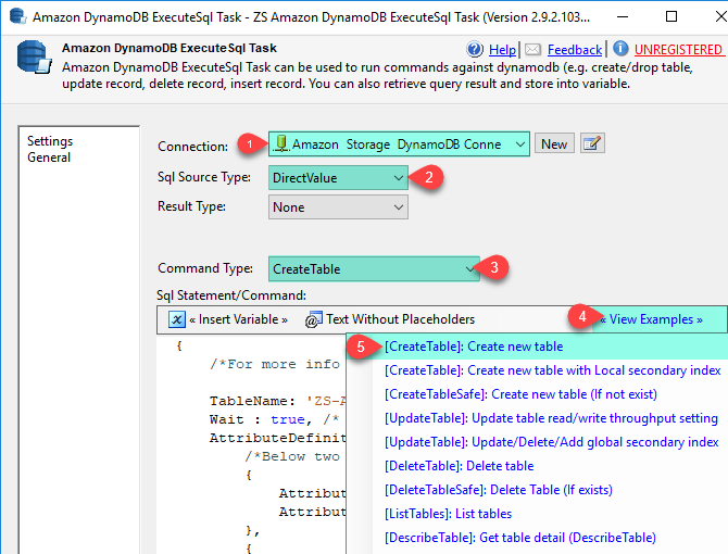

How to Create Table using Amazon DynamoDB ExecuteSQL Task.

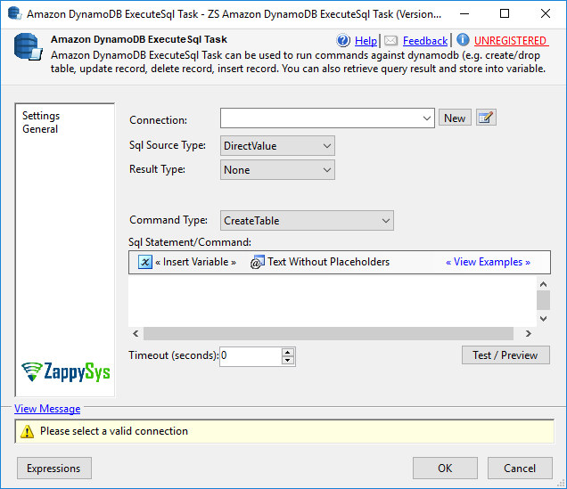

  1. Double click on Amazon DynamoDb ExecuteSQL Task to configure it.
  2. Select Connection, set SQL Source type to DirectValue and CommandType to CreateTable.
    Note : Replace Table Name.
        /*For more info visit : http://docs.aws.amazon.com/amazondynamodb/latest/APIReference/API_CreateTable.html */

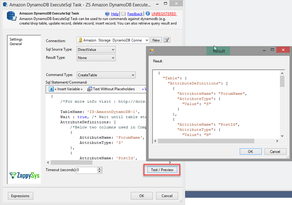

    Run Amazon DynamoDB ExecuteSQL Task - Create Table
  3. Finally, you can run by press Test / Preview button or hit on OK button and Execute Package.

Examples
[CreateTable]: Create new table
This example shows how to create new DynamoDB table with minimum required options. Create table may take few seconds or minutes to provision resources on AWS cloud. See below link for more information on each parameter for CreateTable command http://docs.aws.amazon.com/amazondynamodb/latest/APIReference/API_CreateTable.html
