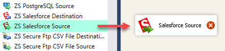

  5. Here, In Visual Studio, drag and drop the ZS SalesForce Source in the design surface.
    SSIS SalesForce Source - Drag and Drop

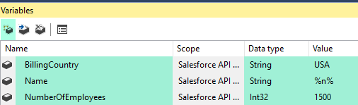

  2. Lets, create a Variable with correct DataType and Value, use following image.
    SSIS SalesForce Source - Create Variable

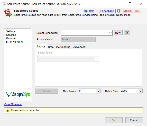

  3. Double click on SalesForce Source to configure it.
  4. Select connection we have created before, set AccessMode to Query, Enter Following Query and Replace Variables if differ name. Click here for more SOQL Query Examples.

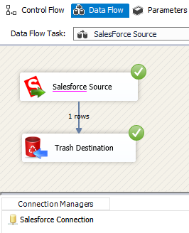

  11. Thats all, just run or execute your package and see data.
    SSIS SalesForce Source Query Mode - Execute

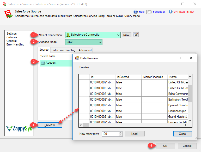

  1. Double click on SalesForce Source to configure it.
  2. Select connection we have created before, set AccessMode to Table and Select Tables from table dropdown list.
    SSIS Salesforce Source - Table mode (get data from object)

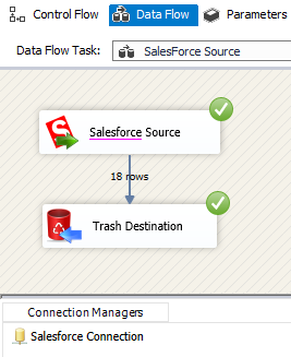

  9. Thats all, just run or execute your package and see data.
    SSIS SalesForce Source Query Table - Execute
