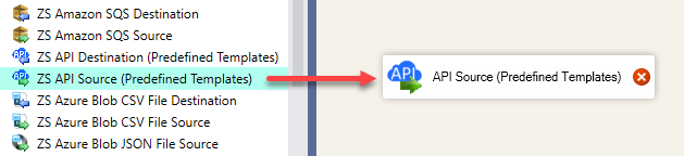

  5. Here, In Visual Studio, drag and drop the ZS API Source in the design surface.
    SSIS API Source - Drag and Drop

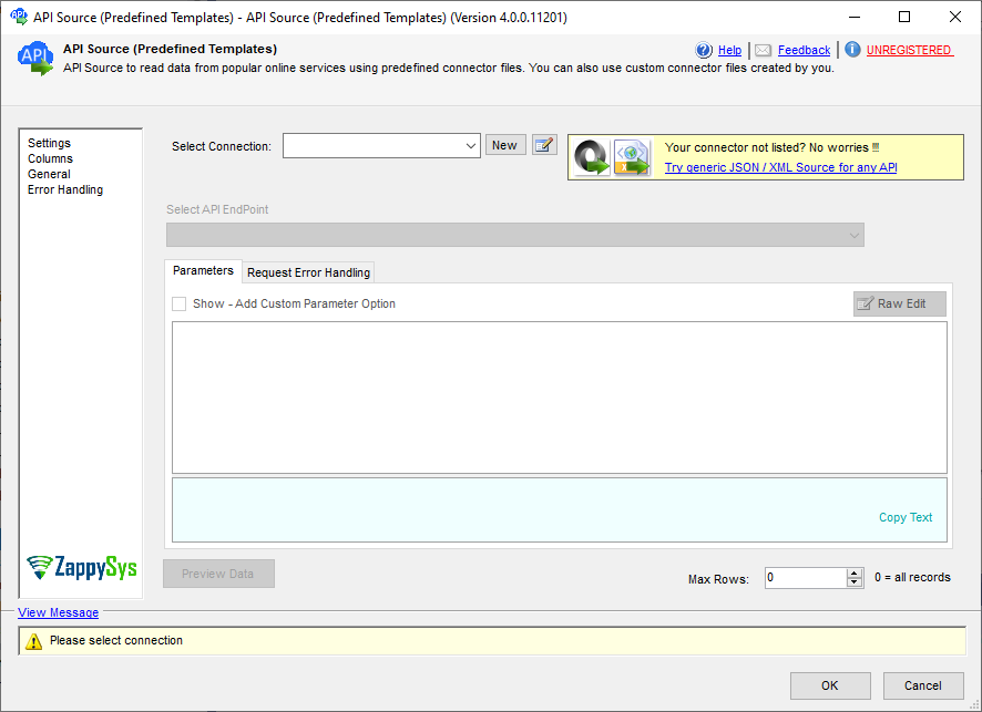

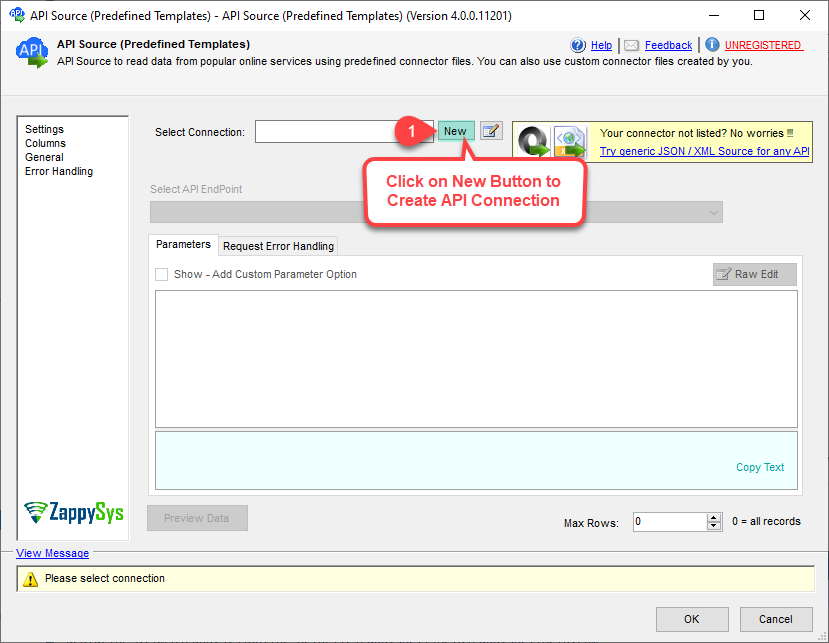

  1. Double click API Source to edit. On UI Click [New] Connection.

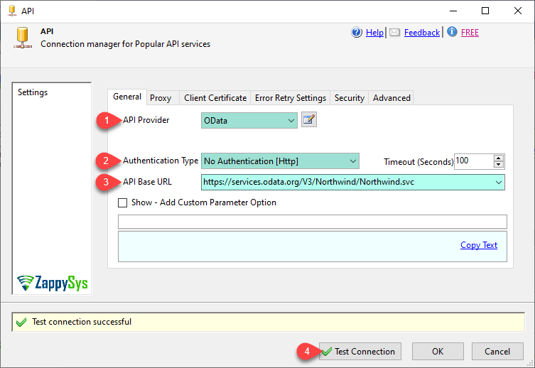

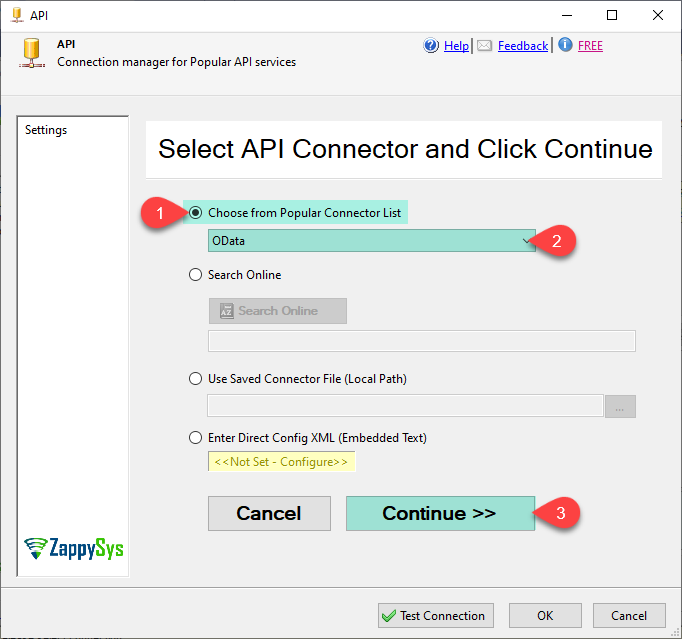

  2. Choose [OData] from Popular Connectors dropdown and Click Continue.
    SSIS API connection
  3. This example doesn't need any authentication so leave everything else default. However in real world you will need to supply Authentication information.
    SSIS API connection
  4. Click Test Connection to confirm everything is good.
  5. Click OK to save UI and go back to API Source UI.

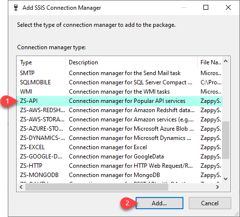

  1. Right click in the Connection Manager panel and click on New Connection.
    SSIS Create New Connection
  2. Select ZS-API Connection Manager from the Connection Managers list and Click on Add Button.
    SSIS API Connection - ADD
  3. On New Connection Dialogbox configure using same steps we described in the previous section (Method #1).
  4. Click on Test Connection to check configure correct or not.
  5. Click on OK button to save API Connection Manager configure setting UI.

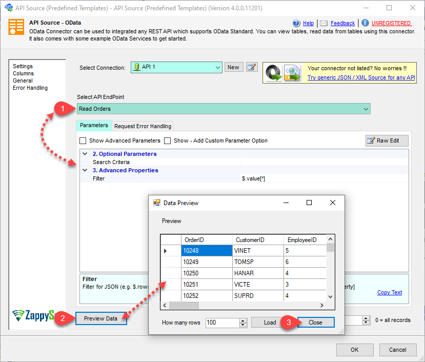

  1. On API Source UI now you can choose EndPoint from the dropdown. Choose EndPoint (i.e. Read Orders) for example.
    SSIS API Source - Configure
  2. Click Preview to see sample data.

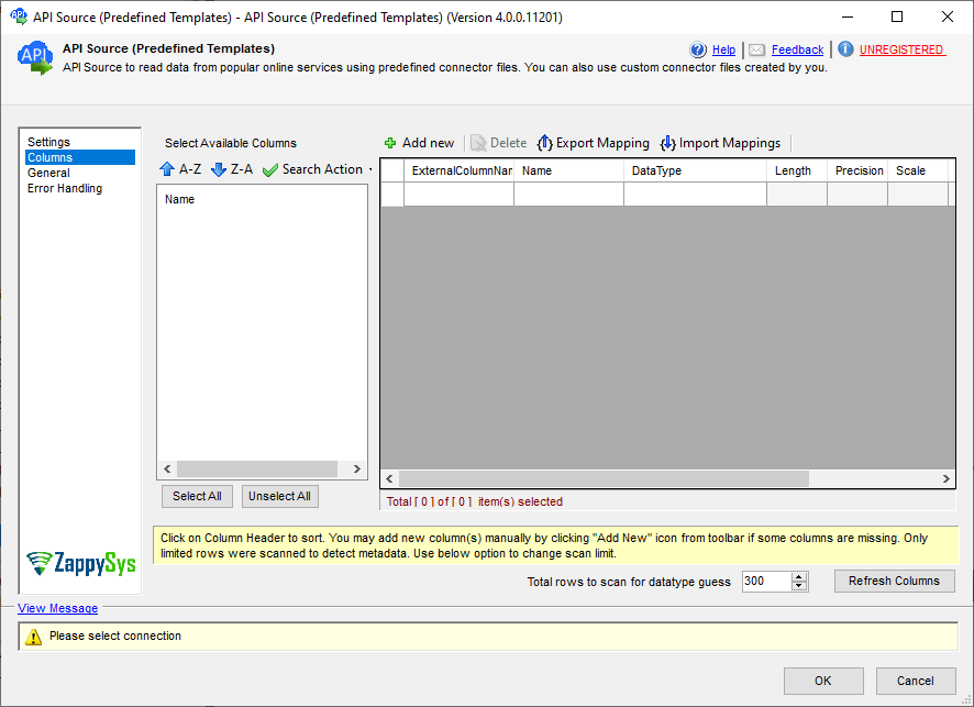

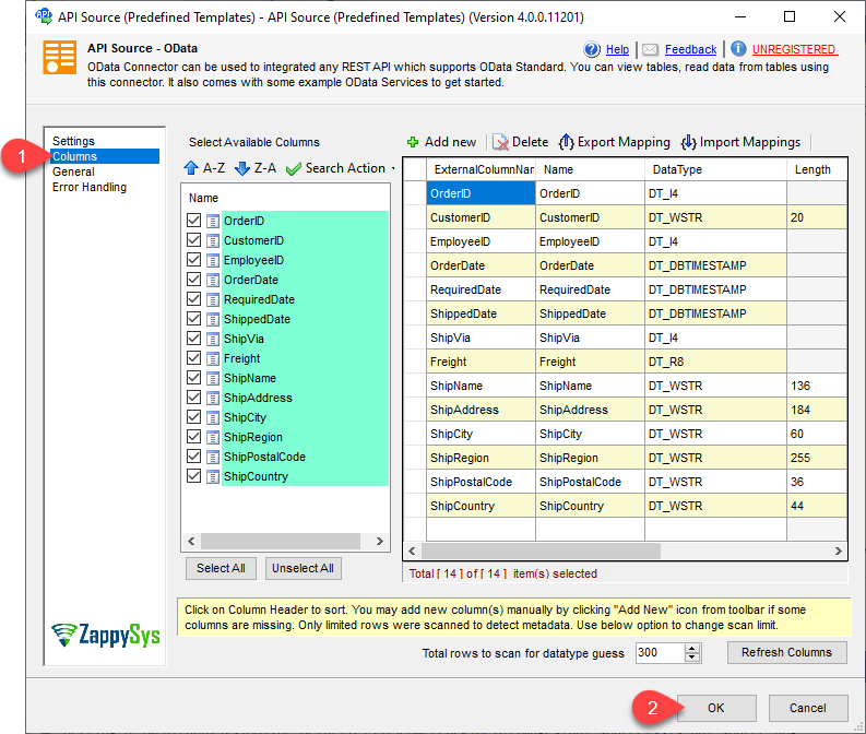

  3. Click on the Columns Tab to review output columns. Here you can uncheck unwanted columns from the output so they dont appear downstream.
    SSIS API Source - Columns Configure
  4. Now click OK to save UI.

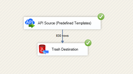

  5. From the SSIS toolbox drag and drop Trash Destination on the data flow designer surface.
  6. Now single click on the API Source, once you see blue arrow from source ... connect it to Trash Destination.
  7. Double click on the ZS Trash Destination to Configure it.
  8. Click on OK button to save Trash Destination UI.
  9. Execute the package and verify data in file (used in Trash Destination).
    SSIS API Source Execute - Table Mode

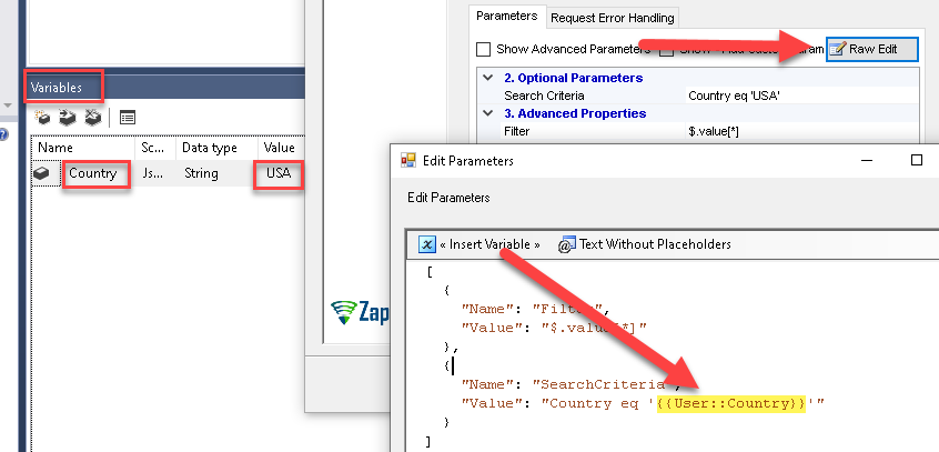

How to parametrize values
There are mainly two ways you can parameterize for API Source. Check this help page to learn more about this approach.
Method #1 - Placeholder Engine
SSIS API Source / Destination - Using Variable for Dynamic Value
Method #2 - SSIS Expression
SSIS Expression Editor - Use of Variable / Parameters

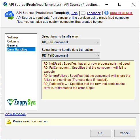

ContinueOnUrlNotFoundError If this option is true then component will continue without exception on 404 error (Url not found). This allows you to consume data gracefully.
ContineOnAnyError Continue when any type of exception occurs during http request
ContineOnErrorForMessage Continue on error when specified substring found in response
ContineOnErrorForStatusCode Continue on error when specified status code returned from web server
ConsumeResponseOnError When error occurs no data is returned. Use this option to get content eventhough error occurs. When this option is checked you can't use [continue on error when specific string found in response] option
ErrorStatusCodeToMatch Status code to match when error occurs and ContineOnErrorForStatusCode option is true. If Response status code matches to this code then task continues to run
ErrorStatusCodeToMatchRegex Status code(s) to match - separated by vertical bar (e.g. 404|405). When error occurs and ContineOnErrorForStatusCode option is true then if StatusCode matches to this code(s) then task continues to run
ErrorSubstringToMatch Error substring to match when error occurs and ContineOnErrorForMessage option is true. If Response status code matches to this code then task continues to run
MaxRows Maximum number of rows to fetch from source. 0=Unlimited
Error Handling

SSIS API Source Error Handling Options
