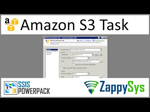

<h2>Download/Upload data to S3 bucket from SSIS</h2>
<a href="https://zappysys.com/blog/check-amazon-s3-bucket-location-region/"><img decoding="async" src="https://zappysys.com/blog/wp-content/plugins/wp-youtube-lyte/lyteCache.php?origThumbUrl=%2F%2Fi.ytimg.com%2Fvi%2FtlW7lpJoWEg%2Fhqdefault.jpg" alt="YouTube Video"></a><br /><br /></p>

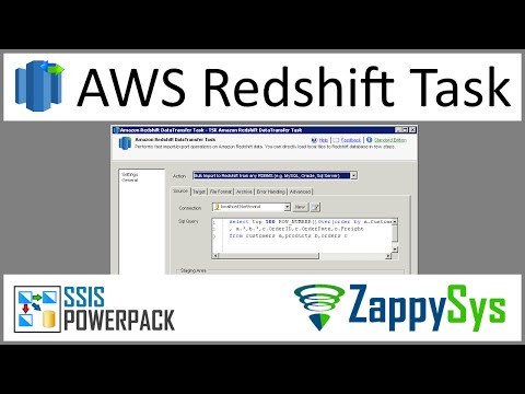

<h2>Load data to Amazon Redshift using S3 Bucket and COPY command</h2>
<p>Below video shows how to use S3 bucket to perform bulk data load into Amazon Redshift using <a href="//zappysys.com/products/ssis-powerpack/ssis-amazon-redshift-data-transfer-task/" target="_blank">SSIS Redshift Data Transfer Task</a><br />
<a href="https://zappysys.com/blog/check-amazon-s3-bucket-location-region/"><img decoding="async" src="https://zappysys.com/blog/wp-content/plugins/wp-youtube-lyte/lyteCache.php?origThumbUrl=%2F%2Fi.ytimg.com%2Fvi%2F5S_p0fNn6a8%2Fhqdefault.jpg" alt="YouTube Video"></a><br /><br /></p>
<p>Amazon S3 provides most common way to store/load data for various AWS related services (e.g. EMR, Redshift). Zappysys is one of the top leading providers who make tools for AWS, NoSQL and other Cloud connectivity providers. Check <a href="//zappysys.com/products/ssis-powerpack/" target="_blank">SSIS PowerPack</a> (For SSIS) or <a href="//zappysys.com/products/zappyshell/" target="_blank">ZappyShell Command line for AWS</a> if you want command line solution. ZappyShell is just single exe file does all heavy lifting for you 🙂</p>
