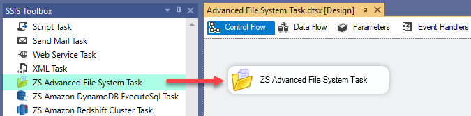

  3. In Visual Studio, drag and drop the Advanced File System Task in the design surface from SSIS Toolbox.
    SSIS Drag and Drop ZS Advanced File System

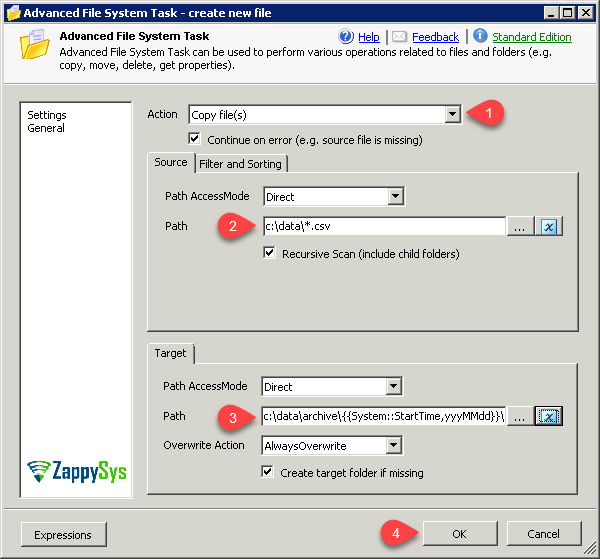

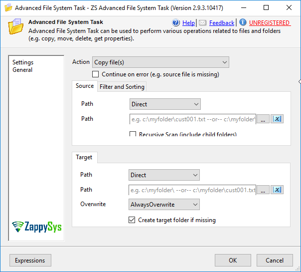

How to copy files using Advanced File System Task.
  1. Now, Double click on Advanced File System Task to configure it.
  2. Set Action to Copy File(s), Select file path from browse button.
    Note: If you want to operation with multiple files then use wildcard pattern as below (when you use wildcard pattern in source path then system will treat target path as folder regardless you end with slash ).
    Examples:
    c:\data\file123.csv (single file).
    c:\data\file*.csv (all files starting with file).
    c:\data\subfolder\*.csv (all files with .csv Extension and located under folder subfolder).
    Set Target Path with Date and Time and file name with suitable extension.
    Advanced SSIS File System Task - SSIS Copy Multiple Files (Use wildcard)
  3. Click OK button to save Advance File System configure setting UI.
  4. Thats all, you can run or Execute task.

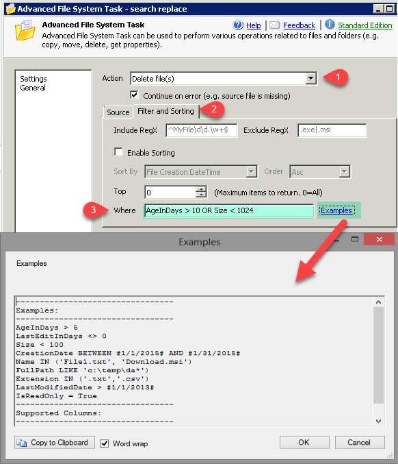

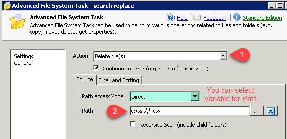

How to Delete files using Advanced File System Task.
  2. Set Action to Delete File(s), Select file path from browse button (here you can use wildcard pattern).
  3. In the Filter and sorting you can use where condition. for more info click on Examples.
    Advanced SSIS File System Task - SSIS Delete files older than X days – Advanced Sorting and Filtering
  4. Click OK button to save Advance File System configure setting UI.
  5. Thats all, you can run or Execute task.

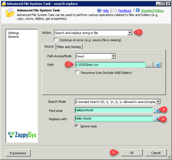

How to search file content and replace it using Advanced File System Task.
  1. Double click on Advanced File System Task to configure it.
  2. Set Action to Search and Replace string in file, select file path. In the Find What and Replace with write string you want to perform. Check on Ignore case.
    Advanced SSIS File System Task - SSIS Search and Replace multiple files (Extended mode and Regular Expression Support)

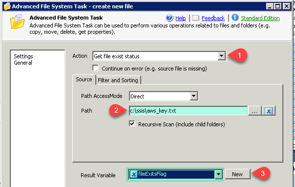

How to check file is exist or not using Advanced File System Task.
  2. Set Action to Get file exist status, select file path. Select Result Variable or click here for create new variable.
    Advanced SSIS File System Task - SSIS check file exists (check for single or multiple files)

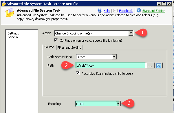

How to change encoding (UTF8, UTF16 or ASCII) of file using Advanced File System Task.
  2. Set Action to Change Encoding of file(s), Select file path (here you can use wildcard pattern). Set Encoding from dropdown list of encode.
    Advanced SSIS File System Task - SSIS change file encoding (to UTF8, UTF16 or ASCII)

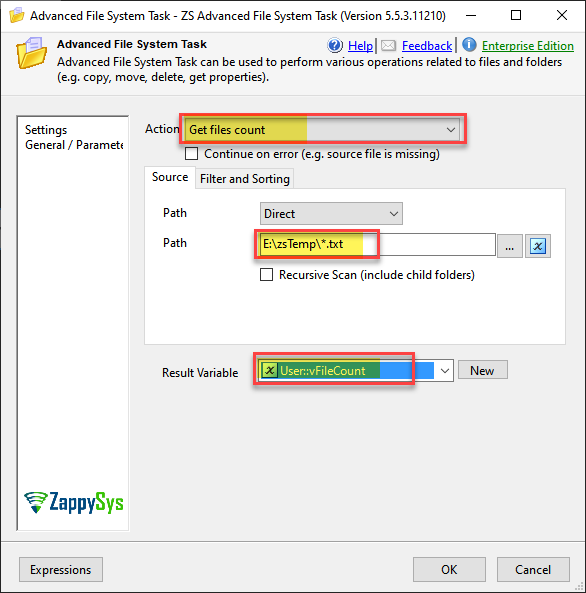

How to get files count using Advanced File System Task.
  2. Set an action to Get files count. Select the file path using a wildcard pattern. Create a variable with an integer data type to store the file count, similar to the sample screenshot below.
    Advanced SSIS File System Task - SSIS get files count

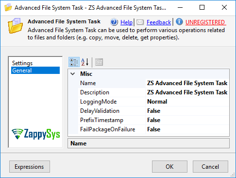

Settings UI
Advanced SSIS File System Task - Settings UI
